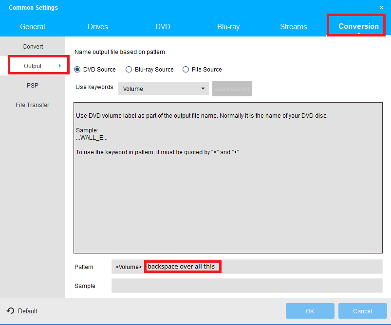

          Also go into common settings/conversion/output and backspace over everything except "<volume>" and click OK to get only the file name.

              Like I said, I tried that but it never changes. From "common settings => conversion => output", I tried "<volume>" and my file was not named correctly. When I went back to "common settings => conversion => output", it showed "<volume>.<title>" again. I even tried making it blank but it still reverted to "<volume>.<title>" again.

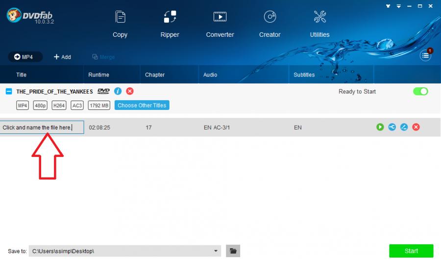

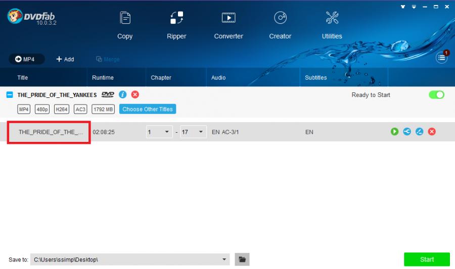

                I'm running 1.0.3.2 also and it works a treat. Select the source and then click right on the file name it will turn blue and you can type over.

                  If you fail to click OK at the bottom nothing will change, it will revert to default.
                    The problem ended up being that you MUST select BluRay or DVD source. If File Source is checked, changes made below will never take effect.
                    So, in the end ... USER ERROR!

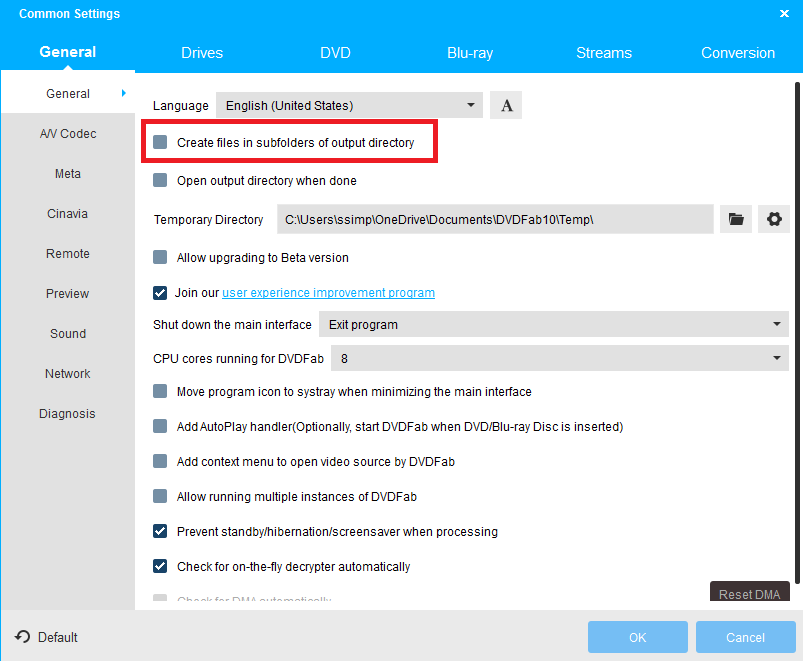

                          While I've solved the file naming problem, the side effect is that my mp4 is being placed two subdirectories deeper than I wished. I have my "Save To" location set and I want the MP4 to go there. instead, it created a Video subdirectory and then a <volume> subdirectory.
                          How can I put my MP4 directly in the specified save location?
                            Uncheck this box:
                              This works well when putting movies onto another drive also so it doesn't go into a sub folder.The renaming works well also.
