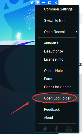

    The developers need your dvdfab_internal.log file and fabcheck_internal.log file to help figure out the slow speed issue, thanks in advance.
Name:	open log folder.png

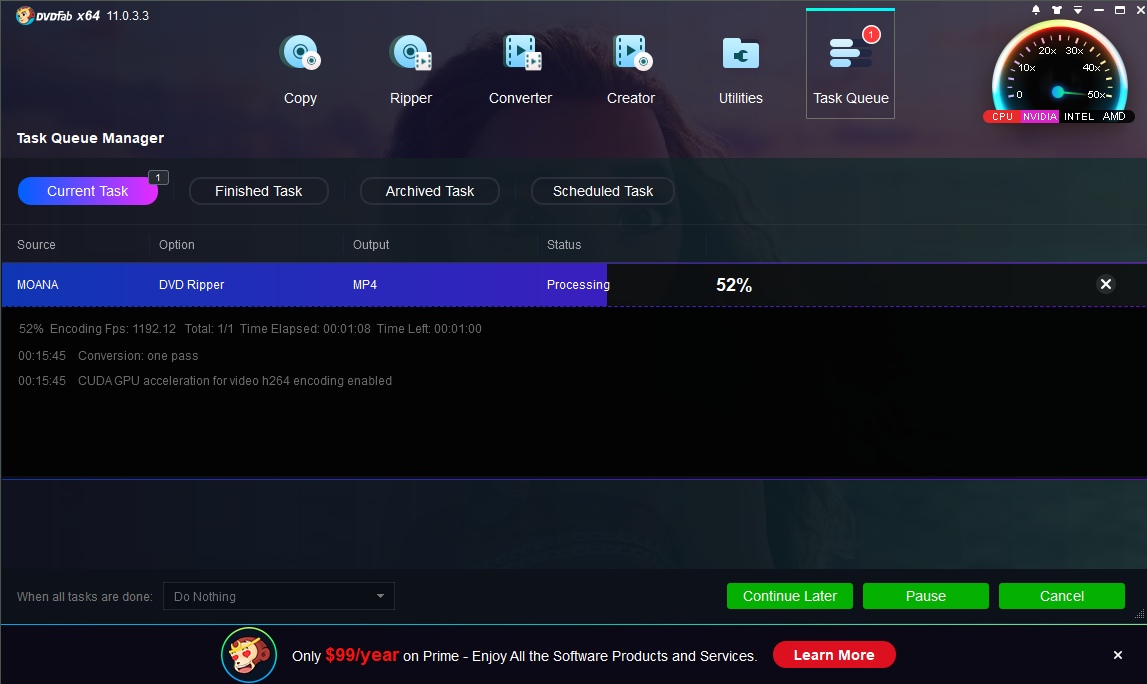

                    As you can see mine hums right along? Click image for larger version
