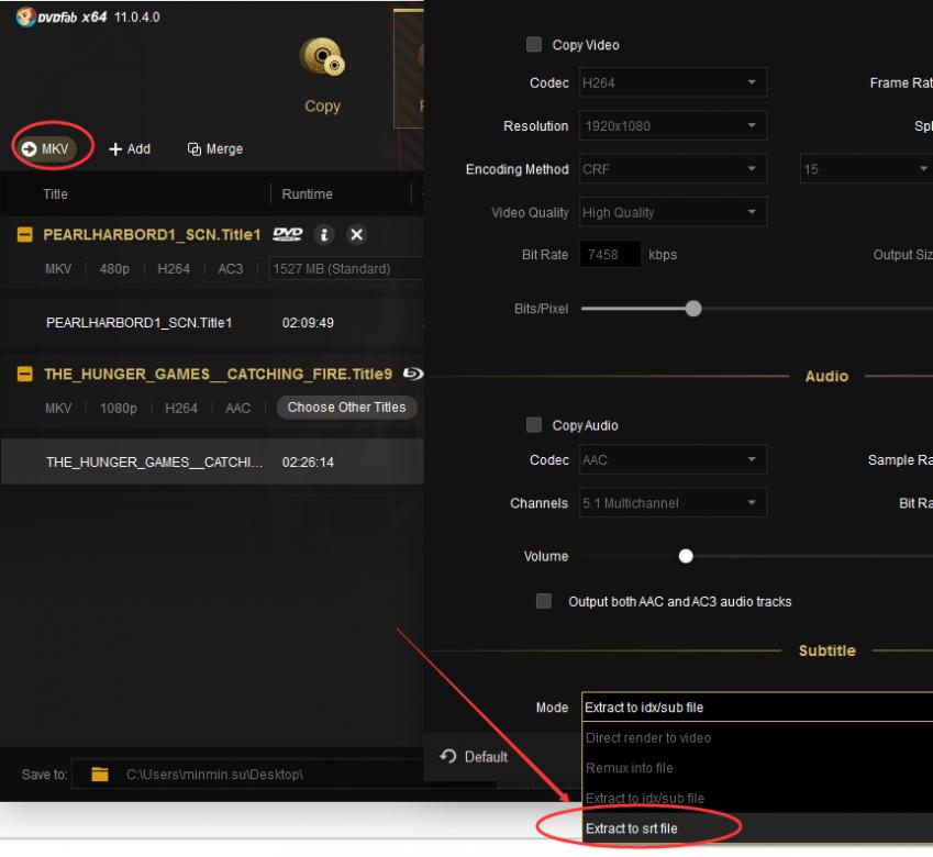

    Hi Beerman64,
    It is in the Advanced Settings window. Please see image attached.

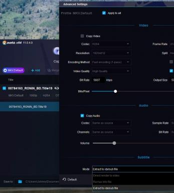

      I had gone to the advanced settings window and there was on three choices for subtitles and Extract to SRT was not one of them. I uninstall DVDFab 11.0.4, redownloaded a new DVDFab (64) version and reinstall with same results. See attached image.

          Should be there, just tested and works fine.
            You can see what I am seeing (from the image above) so there has to be something on my machine affecting my installs.

                Note that the subs dropdown extends below the DVDFab main window (see the image Mona posted above). If you have it set up so that the bottom of the DVDFab main window is at the bottom of the screen, you may not be able to see anything that appears below .

                  You were using profile mkv.default. Please choose other MKV or MP4 profile that comes with DVDFab to see the result.
                    Thank you Mona.
                    Selected the other MKV profile and that SOLVED the Problem
