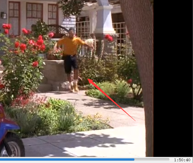

      About the choppy issue, please check the attached image, is this the choppy portion meant?Click image for larger version
Name:	choppy portion.png
      We cannot duplicate the sync issue with this source while using 23.976 (Same as Source) though.
