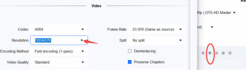

    That could be a UI problem.
    You may go to the advanced settings panel to manually adjust the resolution.
