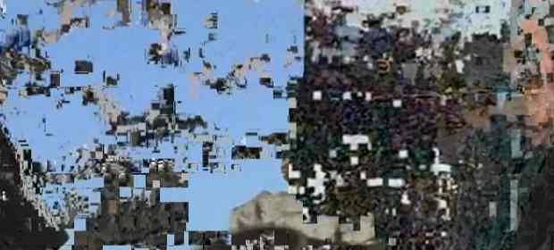

    It was a successful encode no errors but when I play the file back using KMPlayer and PowerDVD10 the movie has 2-3 mins in 3 different places of terrible pixelation, the image is completely like a mosiac, the sound is fine.
    Most of the movie is fine but affected scenes look like little squares and the picture is masked by them. I have included a sample of what it looks like.
    I use a bitrate of 9000 MKV.
    Help!!!

    I'd give it a try with the DXVA disabled and see what the result was like.
    DXVA has been known to be a little quirky.
      it worked with software. thanks
        im a bit annoyed as now i feel that i should not be using DXVA cos it sometimes causes these glitches even though it cuts some time out of the encode and my graphics card cost a bomb lol.
        CoreAVC just gives me a crash and error report everytime.
        Obviously it doesn't feel safe to use DXVA!
        Wondering if AVC or VC1 is used, if there would be a difference of one of them never glitching with DXVA? Anyone know?

          I'd be looking for updated drivers for your card.
          As I said, DXVA seems quirky and to be quite honest, I personally would only buy a CUDA capable card.
            OK I will stick to software only. I have updated to the latest, I'm freakishly obsessive about drivers!
