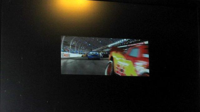

            I am attaching a picture of my TV screen playing a 720x480 DVD with the soft player off. You can see what 720x480 looks like without software expansion. It has been my experience that bigger is better while maintaining the aspect ratio. Less expansion for the software to try to fill in the blanks, I go straight to the top of the list when I intend to play on the TV. It’s like scanning a wallet size picture and trying to make an 8X10 out of it, the quality just doesn’t hold.
              What resolution is your TV? If the screen shot is 720 x 480 it must be about 1900 x 1500??
                Well you are close Floyd; it’s a 16:9 HD TV so the native frame resolution is 1920x1080.
                1920x1080=2,073,600 pixels
                720x480=345,600 pixels; or about 17% of available pixels on the TV.
                Fortunately for us both the TV and DVD players have processors to scale to the display. So not coincidentally an 8.5GB SD disc divided by a 50GB Blu-Ray disc is 17%. So anyway if you have an HD TV (or even if you don’t) don’t worry about the 720x480 frame resolution, the scaler processor renders it quite meaningless. Just experiment, find a compromise you can live with and go for it.
