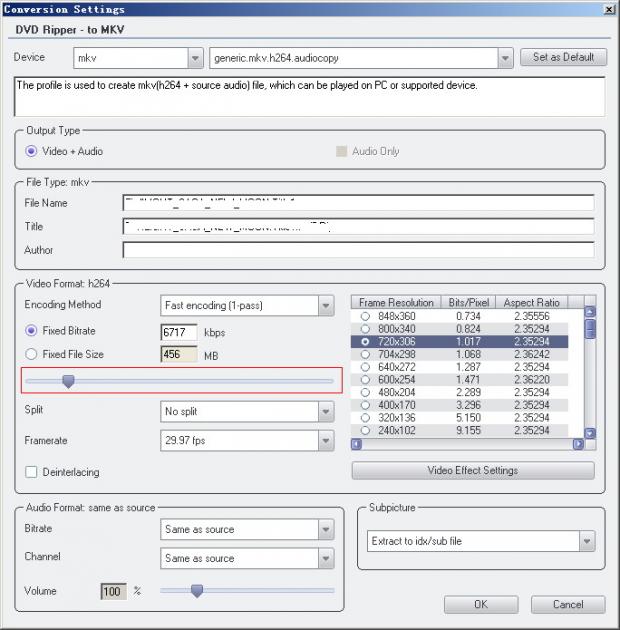

        2) When you use "generic.mkv.h264.audiocopy" profile to convert your original DVD discs, please insert the original movie to your DVD drive, select the titles you need to convert, click on "Edit", open "Conversion settings", and drag the sliding bar (seen in the attachment) to the right side to change output size to bigger size according to your needs.

          I also looked at the "generic.mkv.h264.audiocopy" profile and did know about the slider being able to change either the bitrate or the end file size. However, at the extream of the slider you could re-encode a 6GB DVD into a 36GB MKV file? I was wanting to just do a simple remux not involving any new re-encoding.
