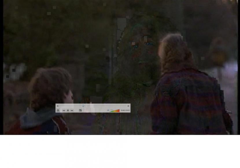

                        I am still having problems with pixelattion it only appears to happen in wmv zune xbox etc. I really want to use zune, wmv as this files are very common files.

                        Movie jumanji
                          Hi Justin,
                          I just convert a DVD iso to wmv file using V8078beta-DVD Ripper-"zune.wmv" profile, the result is i can play the output file in window media player with no pixelattion. Which player software did you use to play the output wmv file on your computer? Have you tried to manually change the video framerate in Common Settings window?
                            I used VLC media player by far the best player out their and i don't think i changed the framerate. My dvd is pal 25 000 fps
                              Hi Justin,
                              I have reset video frame rate to 23.976fps in conversion settings, please try this mannually change to see if you can get output file playing well.
