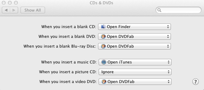

                    I turned DVD Player off so that it would not open up a disc when inserted.
                    I don't think it is any other software causing a conflict because last night I formatted a new drive and installed it in the mini, then installed a fresh copy of OS X and a fresh copy of Blu-ray Copy. There was no other software installed on the Mac. Same problem occurred. I've tried USB, Firewire 800, and SATA. Same problem occurred. I'll post a screenshot of how system preferences is setup below.
                        your settings are correct for sure same way
                        as I have mine set up.

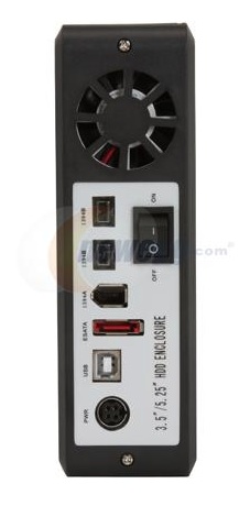

                        You said your blue ray drive was a internal correct or is it a firewire or usb external all the info you can give will be of great help to dvdfab to correct any flaws not all machines pc or mac work the same way.

                            Internal drive in a external case. It accepts USB 2.0, Firewire (400/800) and eSATA. See attachment. It uses the latest Oxford 934DSB Chipset.
