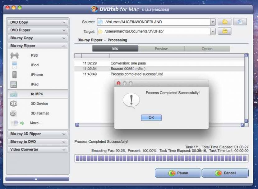

              As Mona suggested in answer to my question, I did switch the two optical drives. Once I put the Pioneer BDR-206D Blu-Ray drive in the upper optical bay and the Apple-supplied LG DVD-RGH61N "Superdrive" in the lower bay, DVDFab was then able to read from the Pioneer drive.
              That doesn't mean that everything's perfect by any means. In fact, the software seems to fail for no discernible reason. In one case, the GUI froze up at the 60.xx% mark and the cursor was "beach-balled" whenever it was over a DVDFab window, yet the Blu-Ray rip completed and the extracted M4V file was good.

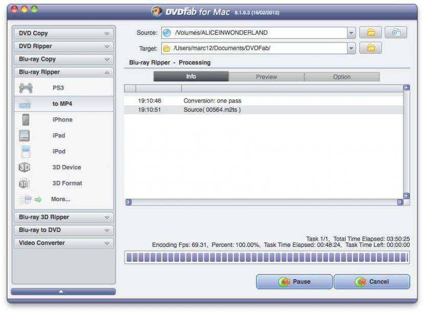

              On the other hand, I've had errors happen and a "Work 1 failed" message at the 99.82% mark. It's also gotten to 100.00% and the GUI will not finish the rip process (though the ripped file was OK).
              I'm attaching a couple of images. The one timestamped as 2012-03-09 at 11.01.10 PM shows the last case I mentioned. The Task Time Elapsed is 48:24, Task Time Left is zero, the Total Time Elapsed is 3:50:25; meaning I let it go for over three hours after it got to 100.00% yet the rip did not "finish."
