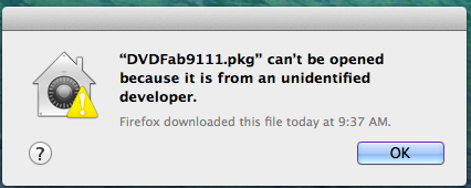

    I recently tried to install DVDFab 9.1.1.1 but received the following error message:
    "DVDFab9111.pkg" can't be opened because it is from an unidentified developer.
Name:	Screen Shot 2013-12-01 at 10.22.19 AM.png
    I was able to get around this by going to System Preferences -> Security & Privacy. If you have recently tried to open the app you should see a notice at the bottom with an "Open Anyway" button. Click that and it should launch successfully.
    Is there any chance that DVDFab will become an official Developer so that updates in the future won't have to go through this hassle?
