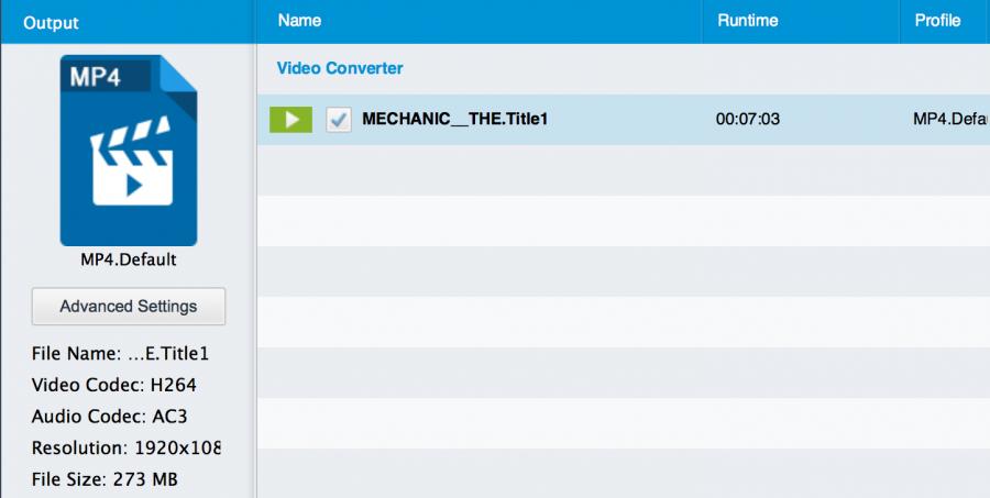

              Sure thing. Here's how I obtained the attached log.
              I used what is essentially an MKV passthrough copy of the first chapter of The Mechanic, which is 1.7 GB in size. VLC reports that the video codec is "H264 - MPEG-4 AVC (part 10) (avc1)".
              I drop that mkv into the corverter tab, set the MP4.Default profile (fast encode, standard video quality) and ensure that the Video Decoder H.264 setting is "Software".
              The conversion takes a few minutes and produces an mp4 file that is close to the estimation on the sidebar (see attached screenshot.)
              Then I change the H.264 setting to "Mac OpenCL" and run the conversion again, without touching anything else. It takes just a few seconds to run and produces an mp4 file that is about 1.5 GB in size, even though the side bar shows it should be 273 MB. Here's a file listing where you can get a better idea of the source and processed file sizes:
              $ ls -lh MECHANIC__THE.Title1.*
              -rw-r--r-- 1 mattyj staff 1.6G Dec 27 01:38 MECHANIC__THE.Title1.mkv
              -rw-r--r-- 1 mattyj staff 1.4G Dec 27 02:05 MECHANIC__THE.Title1.opencl.mp4
              -rw-r--r-- 1 mattyj staff 277M Dec 27 02:03 MECHANIC__THE.Title1.software.mp4
