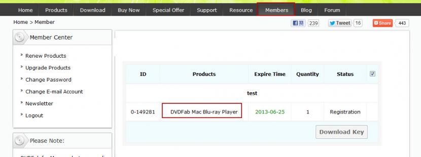

                          Let's clarify the issue from the beginning. Please follow these steps as below.
                          1. Delete "DVDFab Media Player.app" in /Applications and the "DVDFabPlayer" folder in /User/user name/Documents/. Then empty Trash and restart your Mac.
                          2. Reinstall DVDFabMediaPlayer.
                          3. Running Player.

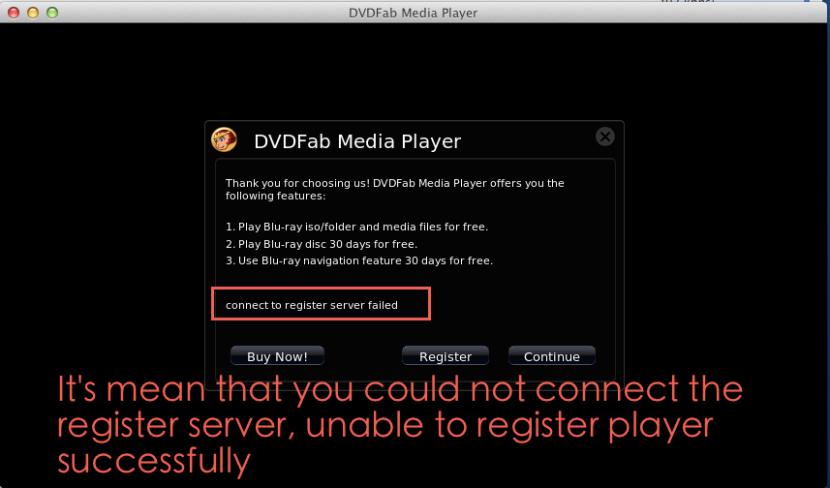

                          - Need confirm that you could connect the register server. If you see the screenshot, you could not connect the register server to register player successfully, you should use a VPN on your MAC and have a try.
                          Log in HS_internal.log file: /User/user name/Documents/DVDFabPlayer
                          Loading: /Applications/DVDFab Media Player.app/Contents/MacOS/system/libcpluff-x86-osx.so
                          ADDON: cpluff: 'Could not read plug-in directory /Users/user/Documents/DVDFabPlayer/addons: No such file or directory'
                          Running the application...
                          thread start, auto delete: 0
                          Start get sys number.
                          GetBDFileInfo listen thread started.
                          Serial number is: 55ADE930-5FDF-5EC4-8429-15640684C489
                          Reg URL link is: https://www.dvdfabstore.com/auth/v2/
                          Version is: 1033
                          Product is: 3
                          Connect type is: 1
                          Times of connecting error is: 0
                          Get registration info failed, the return string is:
                          connect to register server failed.

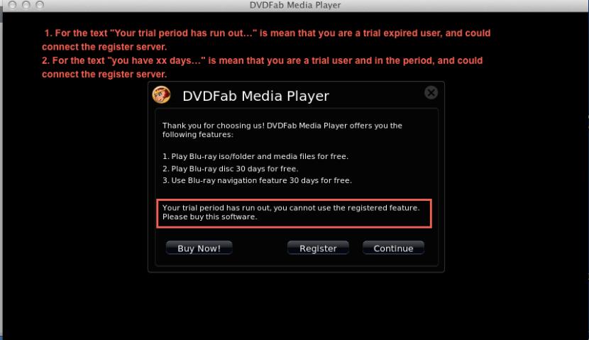

                          If you see the screenshot as below, good news, you could connect the register server and should be register player success.
                          Version is: 1033
                          Product is: 3
                          Connect type is: 1
                          Parse string is: 1200:0
                          Parse string result is: 1200 : 0.000000
                          Set product left days: 1200 : 0
                          Parse string is: OV:1033
                          Parse string is: BV:
                          ###Check license: result=1
                          ###Check license: The version is correct and will get user's license info...
                          ###Check license: trial expired user.
                          - Make sure that you have purchased DVDFabMediaPlayer_MAC product.
                          Log in the Members center and check the status of your account from http://www.dvdfab.com/member.htm.

                          If you could connect the register sever but still could not register player successfully, please post the HS_internal.log file in /User/user name/Documents/DVDFabPlayer.
                          If you could not connect the register server please use the VPN and have a try.
