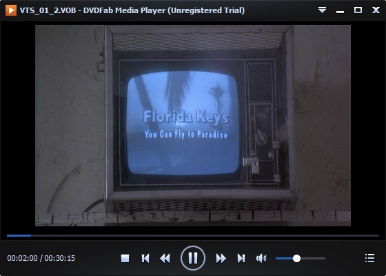

    When I play a VOB file directly from the VIDEO_TS folder of a DVD HDD copy (using the Open Files option in DVD Fab Media Player) the VOB initially loads and renders fine in a Fab Media Player window.

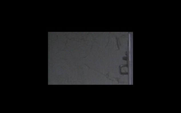

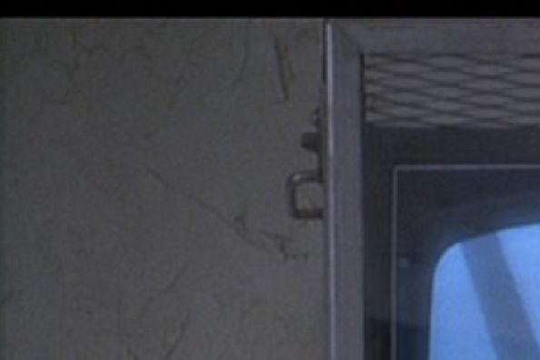

    Hitting F11 switches to full screen, but the video actually appears cropped and massively zoomed so only about the top-left 1/6th of the video frame is shown fullscreen. However the zoom level is still set at 1:1.
    Interestingly, reducing the zoom when in full screen to 1:2 again only crops the already cropped/zoomed portion so you end up with even less area of the video frame displayed.

    Windowed, FullScreen, FullScreen 50% zoom views attached.
