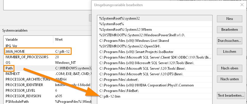

                        Ok solved it. I never knew PlayerFAB needs Java to work?!
                        What I did:
                        - downloaded JDK12 zip, extracted it and moved the jdk-12 dir to C:\jdk-12
                        - Windows Logo > type "advanced" > extended system properties > Environment variables:
                        -- added JAVA_HOME as an environment variable with C:\jdk-12 as value
                        -- added C:\jdk-12\bin to the already existing environment variable "path"
                        - opened PowerShell as Administrator and executed (not sure why this was needed. maybe this saves a reboot?!):
                        setx -m JAVA_HOME "C:\jdk-12"
                        - executed this to check if java is working properly:
                        java -version
