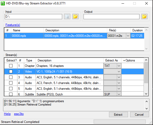

    I have the European four disc set of the movies with all including Dutch and French subtitles.
    The last movie doesn't show the ATMOS audio track using eac3to (latest version, 3.26). I know it can show ATMOS audio tracks because I checked with my Terminator Genisys disc.
    I've attached the log file for this disc. Below is what eac3to shows me in a command prompt.
    If there is anything I can do to help test or otherwise provide, let me know.
    F:\DiscRip\HG4>eac3to d:
    1) 00000.mpls, 00031.m2ts+00000.m2ts+00020.m2ts, 2:17:25
    - Chapters, 16 chapters
    - VC-1, 1080p24 /1.001 (16:9)
    - AC3, English, multi-channel, 48kHz
    - AC3, French, multi-channel, 48kHz
    F:\DiscRip\HG4>eac3to d: 1)
    M2TS, 1 video track, 3 audio tracks, 3 subtitle tracks, 0:00:29, 24p /1.001
    1: Chapters, 16 chapters
    2: VC-1, 1080p24 /1.001 (16:9)
    3: AC3, English, 5.1 channels, 448kbps, 48kHz, dialnorm: -27dB
    4: AC3, French, 5.1 channels, 448kbps, 48kHz, dialnorm: -27dB
    5: AC3, English, 5.1 channels, 448kbps, 48kHz, dialnorm: -27dB
    6: Subtitle (PGS), Dutch
    7: Subtitle (PGS), French
    8: Subtitle (PGS), French
    F:\DiscRip\HG4>

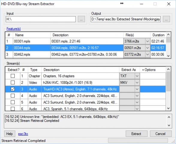

        You need eac3to v3.31 for it to correctly recognize the TrueHD 7.1/ Atmos stream. v3.30 won't see it correctly.
        I also have the EU edition of Mockingjay 2 and you need to be using the correct playlist which is 344. According to your image above you were looking in the 000 playlist.

          The playlist is because that's what passkey offers or opens up?
          Not sure yet how to see all playlists.
            I have eac3to v3.31 and even using the same "HD-DVD/Blu-ray Stream Extractor" it doesn't show me any other playlists.
            But I also see a bigger difference with your EU disc.
            Mine has a VC-1 video track where yours has a h264 video track.
            Seems we have different discs anyway.

              They must be different because when I try and pull up 000.mpls I get a whole new list of .mt2s file associated with it and also your correct about VC-1. that must be only on yours and not mine.
              Sorry for the confusion bro.
                No problem. Interesting to see EU has two different video encodings.
