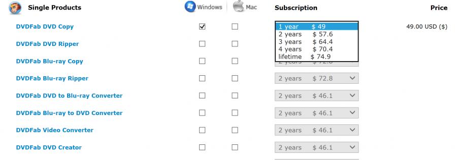

                    Here is my recommendation, not so pricey: http://www.dvdfab.cn/order.htm?pid=dvd-copy
