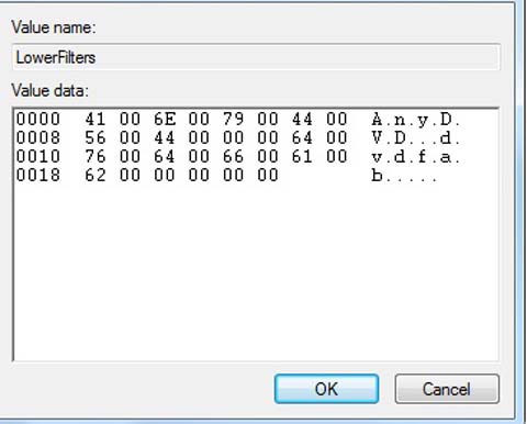

                      Could someone with both decryptors installed be kind enough to post the contents of the value:
                      LowerFilters
                      in this registry key:
                      HKLM\SYSTEM\CurrentControlSet\Control\Class\{4D36E 965-E325-11CE-BFC1-08002BE10318}
                      Thanks in advance.
                      PS: The benefit of having both decryptors may be in case one works for a specific title while the other does not - somewhat improves odds to bypass the protection, if the decrypters are not in a "perfect sync" in that matter (which is a probable case).
                        Is this what you wanted?
Name:	Lower filter value data.jpg
                            Yup, that's it. Have the same values after installing both decryptors on the same machine.
                            Of course, without letting them to auto-start with windows (but it's unrelated to the contents of LowerFilters registry value).
                            Thanks for the supplied information.
                            It gave me a greater confidence that everything is OK with my config.
                            Regards.
