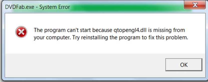

Broken Install
    Broken Install
    The program can't start because qtopengl4.dll is missing from your computer. Try reinstalling the program to fix this problem
    Tried:
    reinstall
    uninstall, then reinstall
    unintall, clean registery/files, reboot reinstall
    Stable Windows 7 64 bit system
    Stop using all those 3d party registry cleaners and you wont get that error.
    Programmer in Python,Java,JavaScript,Swift,PHP,SQL,C#,C++,Go,R
      Bull
      That's bull. Don't jump to an invalid conclusion. If DVDFab would do an actual clean uninstall I would not have to use it.
      BTW this dll is NOT installed by 8.1.3.0 but this version requires it.
        I have seen posts by three members with the same problem with the install of V8130 so it is a valid complaint and problem.
        I did not get the error message so it is another one of those glitch's that is a problem for some but not for others.
        Hopefully it will be noted and fixed ASAP.
          8131 corrects the broken install problem in 8130
