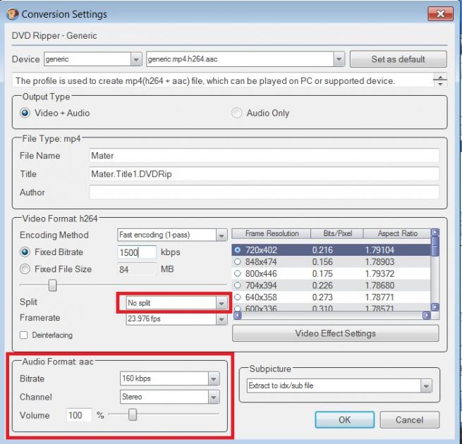

    To make an mp4 from the folder on the hard drive you need to be using the DVD Ripper module, not the Video Converter. I just made an mp4 with aac audio and it worked fine. The profile will default to 5.1 multichannel audio at a very high bit rate that will not play on any portable device I know of (will play on VLC though). Click the edit button and check the audio (lower left of screen) if it is set to 5.1 audio change to stereo and set the bit rate to 160 kbps. You should be good to go.
      To answer the second part of your question in DVD Ripper make sure "No Split" is set. See attached for a screen shot of both settings.
        thank you very much for the help. Still been trial and error regarding getting the audio on the mp4 rip I don't have a 160 kbps or cant find it, so I set it to 128 for starters.
          Should work ok.
