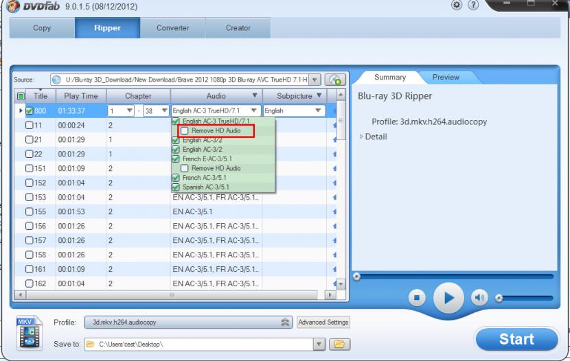

    3. Remove HD audio check box is in Audio list. Please see my attached pic;
    The max bitrate of the profile "3D.mkv.h264.audiocopy" in Fab8 is 30,000. So it isn't a bug;

      See the pic.
