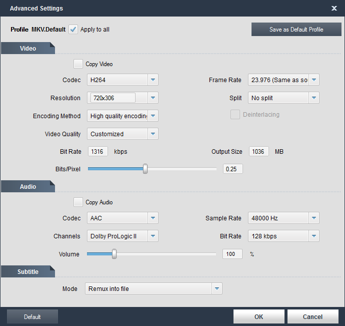

            Once you have DVDFab loaded up and you have a disk in the drive, click on the advanced settings button for the MKV codec that you are using.
            I've attached a .png image showing my MKV settings which I've been using.

                Anytime I've made the mistake of using 5.1 multi channel, there would be no audio when using the Roku.
                But using the the settings in the attached image, everything works just fine.
                  But then you can't play hd sound seems to me this should work that's what pass through or audio copys for. I can't get it to work with hd sound and a regular blu ray player.
                    Pass through isn't going to pass the audio through to the TV set directly. First it's gotta be processed by the device which is playing the video.
                    In the case of the Roku, it won't support 5.1 audio so you get no audio on the TV.
                    When I changed the MKV settings, the only changes that I made is this:
                    Codec: AAC
                    Channels: Dolby ProLogic II
                    I don't touch the Sample Rate or the Bit Rate
                    This part is Optional:
                    Video Quality: High Quality Encoding (This is why it shows as "Customized")
                    All I know is my Mkv videos have been playing back with no problems. The Mkv files I place on a flash drive. From there, they play just fine plugged into the Roku or even my Sony BlueRay player or I can play them on my computer if I want.
