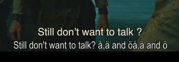

    I noised a problem when converting and using a SRT files.
    When the video is converted all the letters "å,ä and ö" are missing.
    Converting to MP4 ATV3

    I can reproduce the same issue that the letters "å,ä and ö" could not be shown in the converted result.
