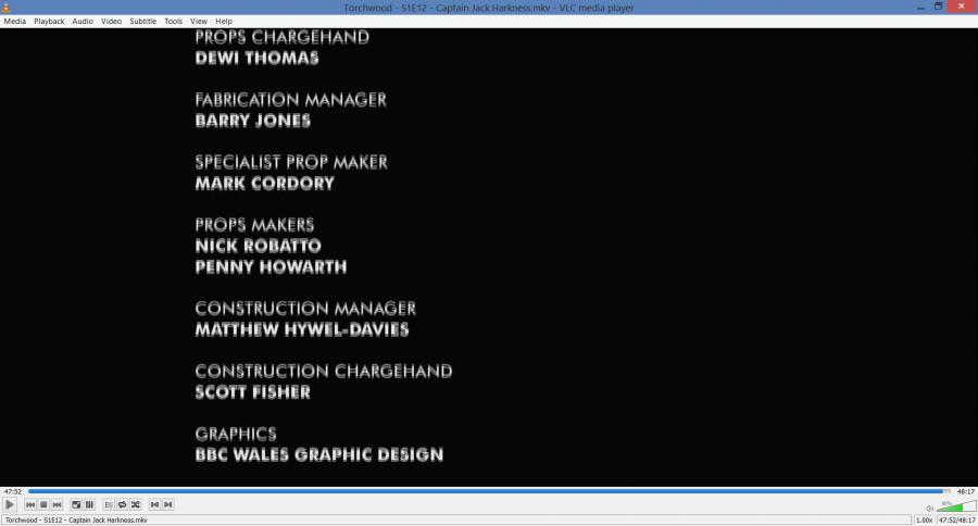

      It is a video stream copy of the original Blu-ray which is identified as 1080i on the box.

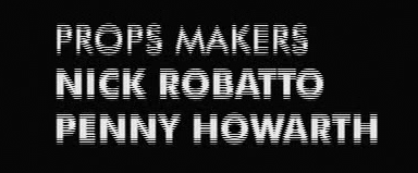

      To finish, there is plenty of combing effect in the picture. See the included screenshot.
        Screenshot take 2, the first one got downscaled.
          Yep there are the mini blinds. Just curious, you never see that anymore.

                But the process produces video artefacts. I have included a screenshot.
                I have tried Software, DVXA and CUDA for the decoding all show the same artefact.
                This particular artefact is common to other conversion software I have. I have seen it in Handbrake, Xmedia Recode (software). Most likely a share library.
                One interesting note, Xmedia Recode using DVXA acceleration is able to avoid those artefacts. I was surprised to see that the DVXA acceleration in DVDFab did not yield the same result.
