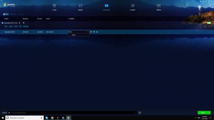

ID:	354650 Here is the media info Format : Matroska

        uploaded screenshot as well. Its very important for .srt subtitles as they have none English parts in them.
        I can upload the subtitle if you like

          This format is not supported, I will report it to the developers as a feature request. Thank you for your feedback.

              The subtitle embedded in the mkv file you reported is not srt.
              If the subtitles are external, then we support .srt, .ass, .ssa and .smi. You can try to add external subtitles to have a try.
