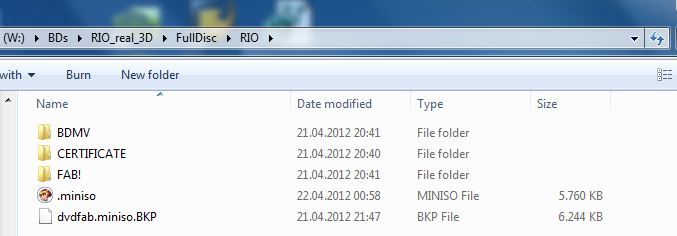

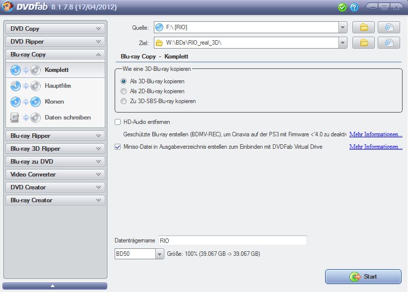

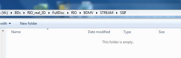

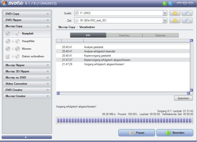

    I re-ripped with latest version, and created Miniso with v1.3.6 of Virtual drive - did not work out though. Find below a more detailed documentation of the steps taken.
    Best
    TJ
    Ripping: jpgs 1-5
    • ssif folder is empty
    • FAB! folder remained (with another 3D BD, this was not the case)
    • 3D playback through miniso did not work at this stage - 2D playback only

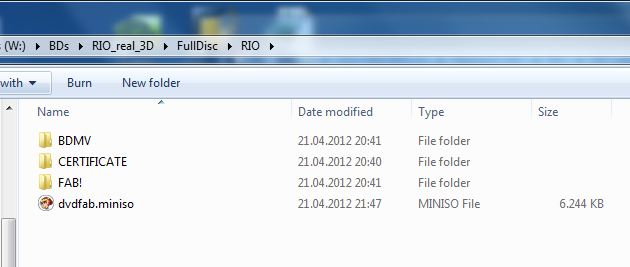

    Virtual Drive: jpgs 6-7
    • created miniso with VD v1.3.6.0
    • strangely this is named ".miniso" (see screenshot) -i.e. without proper filename
    • even after renaming, BD player won't accept it at all: ERROR
    Ripping:

      Virtual Drive:

          ad 1) I had chosen 'copy as 3d Bluray' (see attachment above: attachmentid=6842)
          ad 2) I don't know what "Passkey" is. When doing the 3D-copy, I copied to Harddisk. SSIF folder remained empty. See screenshot:

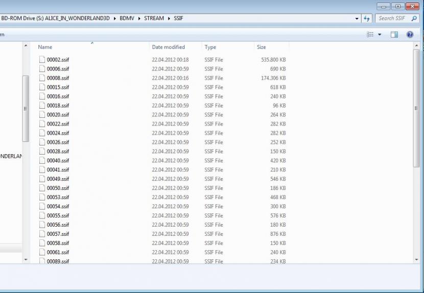

          I now used hte very same HD-copy as before with VD v1.3.6.0. Now, using v1.3.7.0, the SSIF fodler on HD still remains empty, but after MOUNTING, the mounted Virtual BD doeas have files in the SSIF folder. see screenshot:
          The results:
          - on HD: no SSIF files in folder
          - on VD mount, v1.3.7.0: YES, ca. 40 ssif files in folder
          - on PDVD playback, no more "error" message, but the screen remains BLACK. Or the display mode of the TV set keeps switching (with black screen). No BD playback at all.

            If 'copy as 3d Bluray', in harddisk, there are no .ssif giles generated. Need used the movie folder with dvdfab.miniso, after mount dvdfab.miniso into DVDFab Virtual Drive, then the Virtual Drive will be used as normal blu-ray 3D drive.
