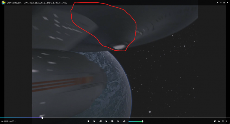

    Colorimetric uniformity in star trek the original series, source from bluray Click image for larger version

    you are using "--level-idc 40 --crf 15.0 --pools 8 --preset medium --rd 3 --no-rdoq-level --no-psy-rdoq --ref 3 --b-intra --no-fast-intra --keyint 250 --min-keyint 23 --rc-lookahead 20 --bframes 4 --b-adapt 2 --slow-firstpass "
    source is bd,
    in hdr video the dark part will have more detail.
    crf 15 is good enough
    since your souce is no hdr video try use 10bit profile, with two pass. test ripper this chapter compare.

      I have colorimetric problems, both with 8 Bit hevc and hevc sdr "with program rippers", but maybe I found the system varying --colorprim <integer|string> --transfer <integer|string> --colormatrix <integer|string> 1, 1, 1 to 2,1,1...i have to do some rehearsals and then I'll inform you
        I have tried various attempts, sdr must be redesigned, the usual black lines formed by dots always come out
            maybe --analysis-save-reuse-level 0 --analysis-load-reuse-level 0-- analysis-save-reuse-level 0
            denotes the amount of information stored during --analysis-save and ‘analysis-load-reuse-level’ denotes the amount of information reused during --analysis-load. Higher the value, higher the information stored/reused, faster the encode. Default 0. If not set during analysis-save/load, the encoder will internally configure them to 5.
            Note that --analysis-save-reuse-level and --analysis-load-reuse-level must be paired with --analysis-save and --analysis-load respectively.
