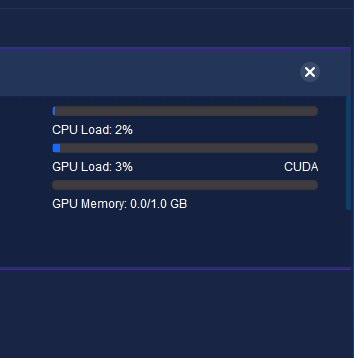

        I don' know of I should start a separate thread on this but noticed that the GPU memory size is incorrectly identified. I have an EVGA Nvidia GTX 1050 GPU, which has 2 GB of DDR5 RAM. DVDFab reports only 1 GB as shown in the attached partial screenshot. Wasn't sure if this is an issue or not (I know its not related to the above issue but just wanted to mention it).
        Thank you
