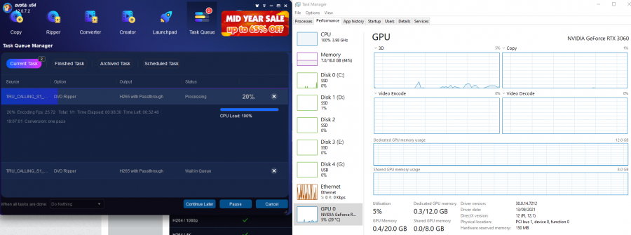

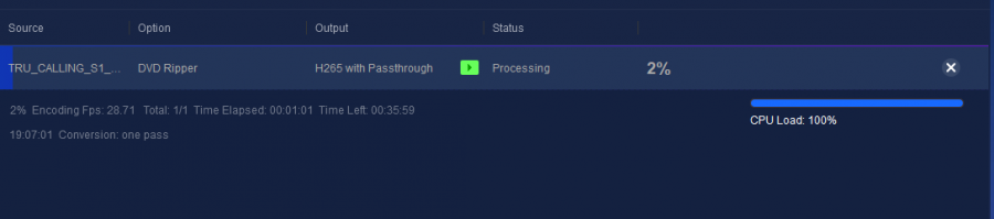

    does Decoding/Encoding work if you roll back to an earlier driver on the rtx 3060 ??
      This is a 42 minute episode and after about 4 minutes showing 38 minutes to complete
      Click image for larger version  Name:	Screenshot 2022-05-21 190830.png Views:	0 Size:	104.1 KB ID:	410118
      Confirmation using an older driver, which shows it is capable of decoding/encoding in H265/10bit, but dvdfab won't have it
      Click image for larger version  Name:	Screenshot 2022-05-21 190938.png Views:	0 Size:	56.7 KB ID:	410119
      this shows the gpu not being utilised
Name:	Screenshot 2022-05-21 191600.png

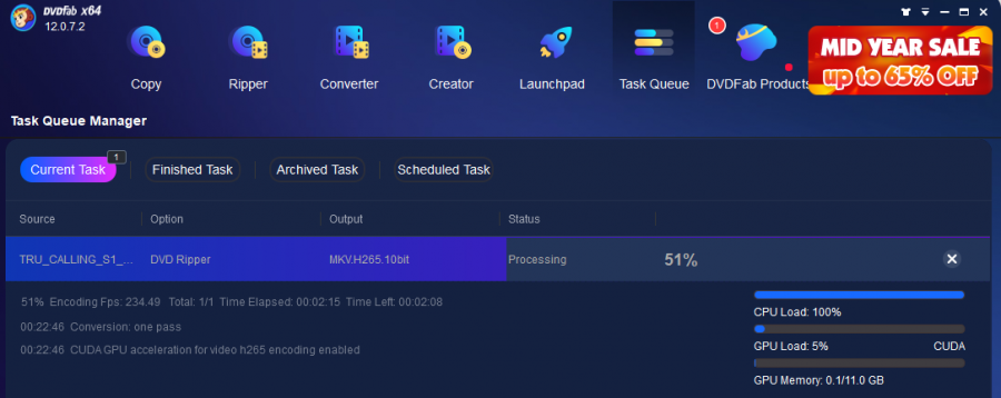

          reinstalled with the latest nvidia drivers and still no go, found on 11.1.0.7 and installed this and cuda works
          retested under 12.0.7.2 and now showing cuda
Name:	Screenshot 2022-05-22 002517.png
          so it looks like V11 must setup the system correctly
