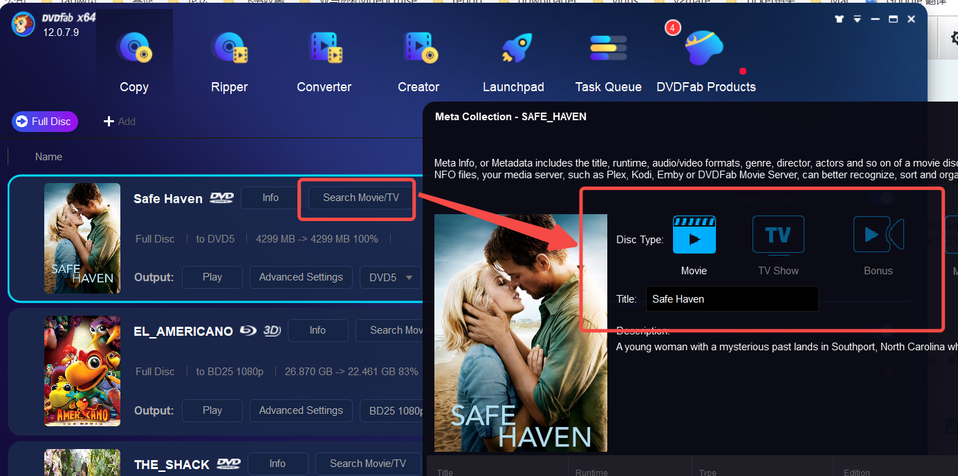

    Normally, you can use the Search Movie/TV feature to correct the meta info.

      I tried, but when I do I get a message that it has already been uploaded by user "xyz" and I do not have permission to change it.
        You can save the changed info to your local drive, DVDFab can apply the one you have saved locally.
