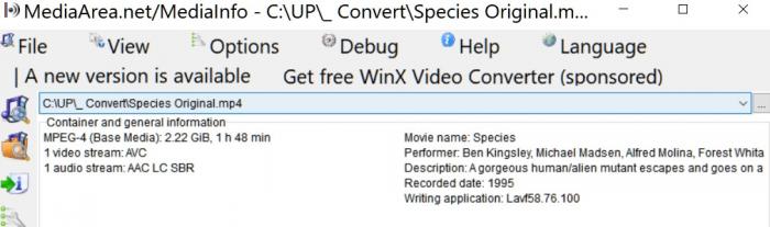

      When I use it, the converter deletes/overwrites the existing media information such as Performers, Descriptions and overlays it with some DVDFab info. (see attached)
      I would like to know if there's some setting I'm missing or is this just how it works.
      There does not appear to be any settings in the menu under Conversion or other settings that will allow it to copy the information from the original file to the converted file media data as is.
      Attached:
      Species Original Media Data
      Species After DVDFab Converter

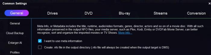

        there's a setting in common settings - general settings - meta - https://www.dvdfab.cn/metainfo.htm
          October262,
          Yes, there are settings under common settings - general settings - meta. (see attached one)

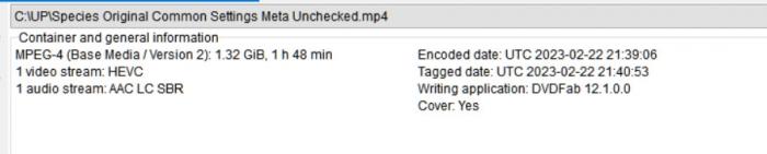

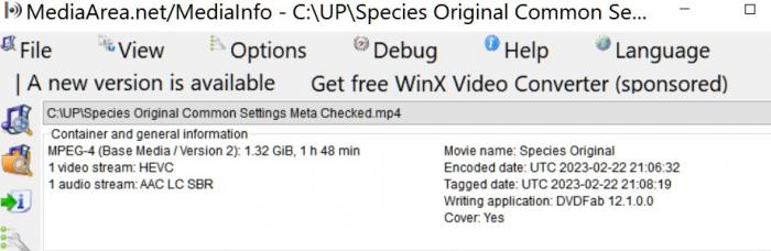

          With Meta Data checked (see attached two) - does not include original info in converted file
          Without Meta Data checked (see attached three) - does not include original info in converted file

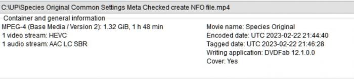

          With create .Nfo file (see attached four) - creates a system .NFO file, but doesn't make any difference in including original info in output file
          I *think* those settings are for DVDFab's benefit to collect information (not sure), but they make no difference in carrying over the information in original files to files converted by DVDFab Converter - such as Performers and Descriptions.
