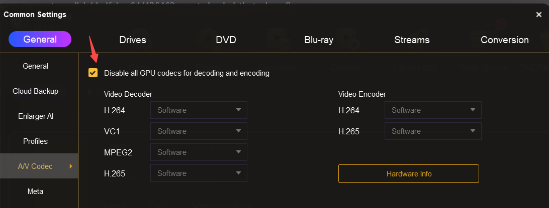

    Please try to disable the GPU and use Software to try again.
      That worked! Thank you Mona. First time I have ever had an issue. I'll remember that trick!
        You are welcome
