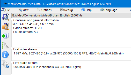

    Here is an example of the MediaInfo for a normal converted file that does NOT have this problem:

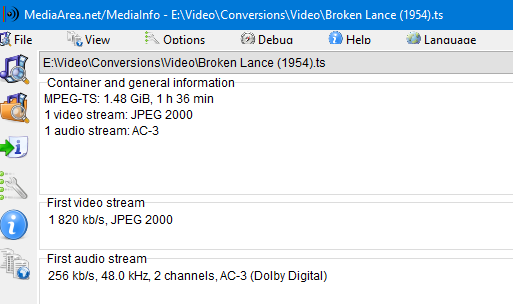

    And here is the MediaInfo from the last converted file I did that DOES have the problem:
    Click image for larger version  Name:	image.png Views:	0 Size:	30.7 KB ID:	432570
    Both of these conversion tasks were run using the same profile and settings. The first one, Broken English (2007).mpg, did not convert properly two times, then did fine on the third try. The second one, Broken Lance (1954).mpg has failed to convert properly three times now, but it did convert fine on the fourth try.
