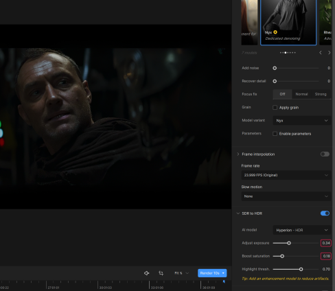

                Topaz 6.01 can do not only 4K but also HDR, please have a look at the screenshot.

                I didn't say that the HDR conversion in Topaz 6.01 is impressive, but that it is better than the one in the current version. After all, HDR has only been available in Topaz for a short time (version 6) and for my needs it is already going in the right direction.
                By the way, try upscaling with Topaz, for example from 720p to 1080p and compare the two, there are no small differences, thanks to the user interface and intervention.
