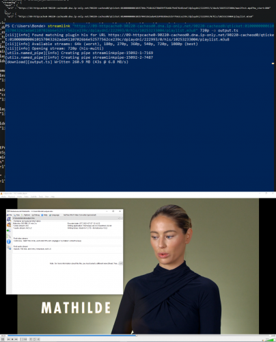

                I would assume you are from scandinavia (RaZorDK) Denmark i would think. The scandinavian version of Discovery+ is using ClearKey as an drm and it looks like StreamFab is not able to detect the streams why i dont know because the only thing you nede to download from Discovery+ scandinavia is streamlink and your network tab in your browser (F12) using the line
                streamlink "mpd/m3u8" 720p -o output.ts
                You can change 720p to 480p 1080p or best
