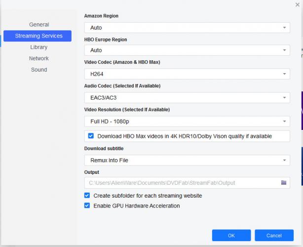

                    here are my settings . I do not have a 4K tv
                      Click image for larger version  Name:	settings.jpg Views:	1 Size:	28.9 KB ID:	401677
                      If you do not have a 4k tv, uncheck the "Download HBO Max videos in 4k HDR/DV..." As you might be experiencing issues due to downloading a 4k video the player trying to format that to play on your 1080p tv.

                        Ok, is this a new thing? In that I never had to "uncheck it before" .
                        Thank you

                          Its relatively new. It was added in 4.0.2.0. But there are only a select number of movies on HBOMax that are 4k (List is here https://help.hbomax.com/us/Answer/Detail/000001167 ).
                          With this option set, StreamFab will download at 4K for the movies on the HBO list, otherwise it will download 1080p (or 720p if you adjust that resolution drop down).
                            And it downloaded fine, Thank you for diagnosing that

                              Its fixed now in 5.0.0.4.
                              If you go Settings -> VIP Services... and set:
                              Video Codec (Amazon & HBO Max) = H264
                              Audio Codec (selected if Available) = EAC3/AC3
                              Video Resolution = Full HD - 1080p
                              Download HBO Max videos in 4K HDR/Dolby Vision quality if available = UNchecked
                              It will download DUNE as H264/AVC, 1080p, no HDR, with 768kb/s 48kHz, 6 channel, E-AC-3 JOC (Dolby Digital Plus with Dolby Atmos)
