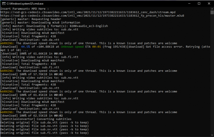

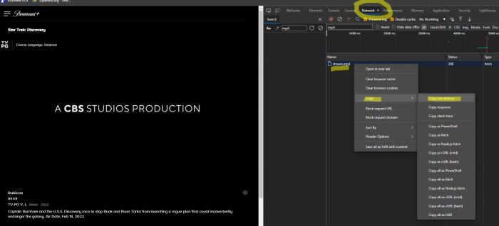

            If it's only the subtitles you need
            Get yt-dlp
            open notepad++
            copy paste this code
            Remember to remove the gap between @ echo (It's a forum thing)
            Code:
            @ echo off
            ECHO Insert Paramount+ MPD Here :
            set /p MPD=
            set MPD=%MPD:_cenc_dash/stream.mpd=_fp_precon_hls/master.m3u8%
            set MPD=%MPD:_cenc_precon_dash/stream.mpd=_fp_precon_hls/master.m3u8%
            echo.%MPD%
            yt-dlp --write-subs --sub-langs "da, fi, no, sv," --write-auto-subs --skip-download --convert-subs srt -N 40 "%MPD%" --output "sub"
            pause
            save it as a .bat
            and run it
            Insert the MPD from your develpertool in your browser (F12 to open)

              #21

                        Click image for larger version  Name:	Screenshot-1.png Views:	105 Size:	98.2 KB ID:	406588
                        Click image for larger version  Name:	Screenshot-2.png Views:	80 Size:	246.2 KB ID:	406589
                        Don't know how to get this working. Have tried to follow the steps and pictures, but really don't know what i'm doing.
