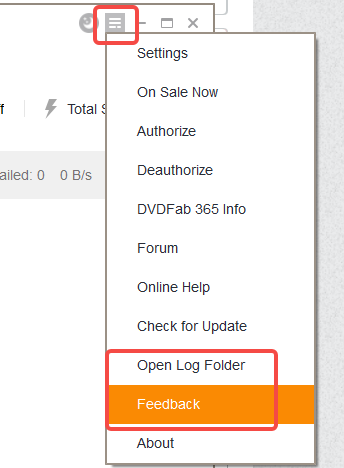

          It needs to use the Peacock Downloader in the VIP section. Please use the Feedback feature in StreamFab to send the log files to us. Thanks.
          Click image for larger version  Name:	screenshot-20220225-115513.png Views:	0 Size:	35.6 KB ID:	406764
          You can also give v5019 a try and see the result: https://d17.dvdfab.cn/download/49_50...b_x64_5019.exe
