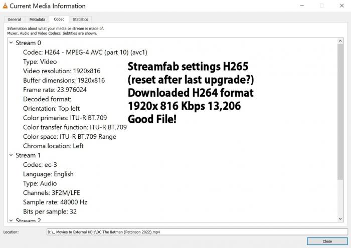

      Also, even though H.265 is selected, it downloaded in H.264
        jpp72, I think you may have pointed out part of the problem. :-)
        1. I had my StreamFab settings set to H264 prior to upgrading to latest version.
        2. When I checked the settings it had reset to H265?
        3. Should you have to check your settings after every upgrade to see if they've changed?
        4. With H265 in my settings it offered more options & included H264 versions.
        5. The files that worked for me were H264 formats even though last upgrade changed my settings to H265 and that's what I downloaded with earlier.
        6. I think the pixalated/bad files are H265.
        Windows 10 64bit with all upgrades
        Tested with VLC & PlayerFab latest versions.
        Nvidia RTX 270 Super
        Display is Dell 2560 x1440 Gsync
        1. File choices offered when you have H265 in Settings, included H264 Formats - which were the ones that play without pixilation.
        2. Good file (no pixilation) with H265 in settings (I had H264 in settings prior to last upgrade) 1920x816 13,206Kbps - H264 Format
        3. Bad file (pixilation) with H265 in settings 1920x1080 11,767Kpbs - H265 Format

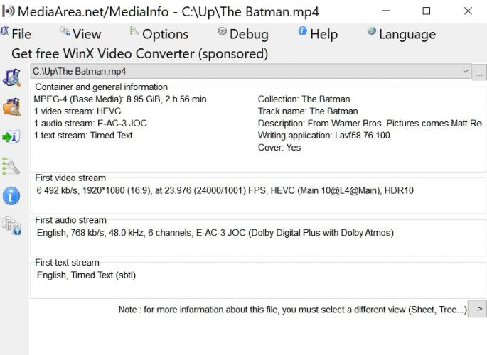

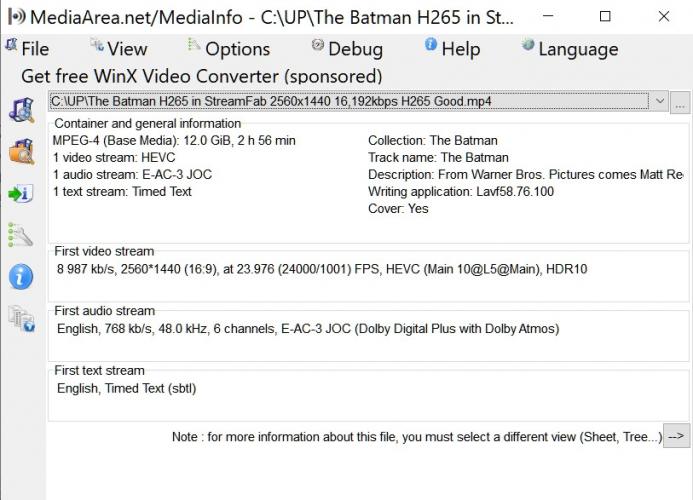

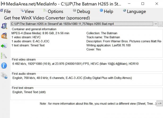

          Used Media Info to get some details on actual bitrate, codec, sound, just fyi...
          H265 in StreamFab settings, Offers various resolutions that output to H265 & H264.
          Pixilation *seems* to occur only in some resolutions of H265 choices.
          The file resolution's and kbps chosen when offered by StreamFab and whether they are good or bad (2 good, 1 bad) and output format are listed at the top
          under c:\up\The Batman... for each file.
          Sound looks nice... Dolby Digital Plus with Dolby Atmos
          Just wonder if it was a player, codec (I remember the days of installing codec packs) or Windows 10/64bit issue I copied the bad file to USB & tried to play it on TV.
          Still bad file & wouldn't play.

              I also copied all the files, bad & good to a USB and tried playing on 2 TV's, 2 BluRay players & via Roku Ultra USB port that have current updates.
              Just in case it was some player/codec issue.
              Bad files (pixelated) would not play on Tv's, BluRays or via Roku Ultra
              The would play the HEVC H265 2560x1440 but not the H265 1920x1080 (see attached)

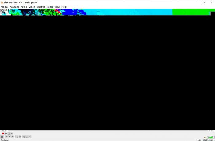

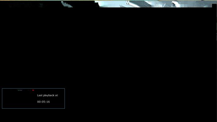

                          Re-did the process with HBOMax just now for The Batman 1920x1080 resolution produces a video file that's pixelated/bad.
                          Attached:
                          Zip file of logs (only for this The Batman process)
                          Screenshot of VLC 3.0.16 playing it pixelated
                          Screenshot of Playerfab 7.0.0.9 playing it pixelated
                          Screenshot of MediaInfo
                          Like I said, I'm probably just gonna download the largest file offered by StreamFab from now on, and convert it to 1920x1080 with DVDFab.
