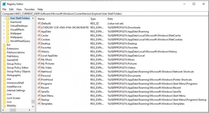

        I upgraded from Win7 Pro Ultimate to Win10/64bit and had some issues with about 4 programs (Acronis True Image for cloning was worse), default save paths, and registry clutter.
        I had save paths for programs/processes that were different/additional to the Windows default ones (see attached default).
        Now they are exactly the same (except for download path) after dropping down to the associated folders and setting the locations of the folders to the default paths (which does a move of files too).
        No more extra special paths and the only one I have set different is the download path to C:\Up
        This had the added benefit of dealing with software conflicts that caused resetting of default apps by Windows 10 to Microsoft ones.
        I also ran Regedit backup (very important do do this first) and then command prompt (as administrator) c:\SFC /scannow that analyzed the registry & fixed any issues it found.
        Rebooted, did C:\SFC /scannow again with no issues...
        Clean installs are probably best, but I have so many programs stuff/that I did an upgrade and it worked out ok.
