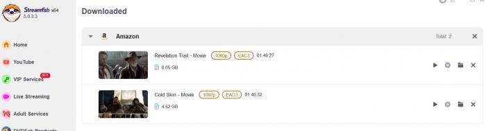

    Downloading 2 files from Amazon Prime -
    1. Revelation Trail
    2. Cold Skin

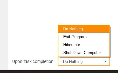

            What is your Task Completion setting in StreamFab set to? Bottom left of the screen.
Name:	Screenshot 2022-05-17 145340.jpg
                It's set to "Exit the Program"

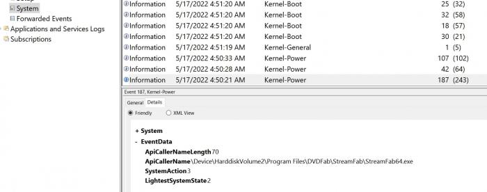

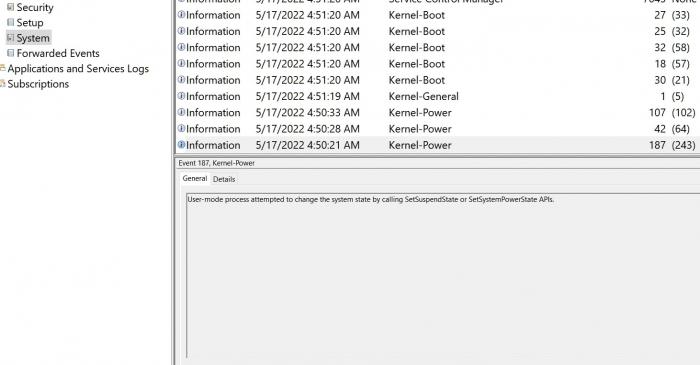

                      But I seem to have found something this time that may point to StreamFab in the Event Viewer.
                      There is an item in Event Viewer under System - Information Event right before it shutdown.
                      User-mode process attempted to change the system state by calling SetSuspendState or SetSystemPowerState APIs.
                      Under "details" of the System/Event it says the app doing this is:
                      ApiCallerName\Device\harddiskvolume2\Program files\DVDfab\StreamFab\StreamFab64.exe
                      To me this means that something StreamFab is doing?
