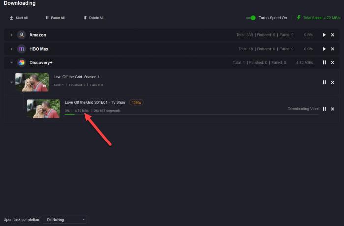

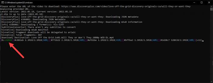

          Take a look at the difference in speed from StreamFab and aria2c on the same episode, same computer:
          StreamFab (4.7 MB/s)

          Aria2c (21 MB/s)

          Obviously the speed is my main concern but i also like to have all my stuff as MKV files. If StreamFab is set to MKV, it doesn't download the Closed Captioned Subtitles (only ones available for Discovery+). I need to set it to MP4 to download the subs and then i need to set it back to MKV for all my other downloads. Unfortunately, i don't always remember to do so and it's annoying that i then have to remux tons of episodes into MKV outside of StreamFab.
