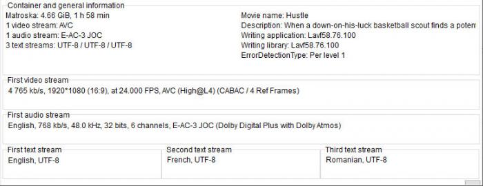

      I am NOT seeing this sound option (EAC3-JOC)(on netflix title Hustle anyway)(or on new fantastic beast title ON HBO, only see english and spanish there), just updated SF to latest. I see Multichannel (EAC3) and Stereo (EAC3), for Hustle. I do have a 7.2.4 atmos system with marantz 6011 and easily playback atmos titles for apple, vudu, disney +, etc as well as 4k and regular blueray. On a side note can i message you directly as to not blow up this post? I have a few ?s about dvdfab also.
      You will not see it in the dropdown. You will only see Multichannel or Stereo and if you select multichannel and check the downloaded file with MediaInfo, you will see it has EAC3-JOC Dolby Atmos
        #18
        thank you much for the mediainfo tip. My Dune file from earlier this year is showing E-AC-3,JOC Dolby Digital Plus with Dolby Atmos, now for the real question. How do i play this file with Atmos. Using Plex on an Apple tv4k it shows as 5.1. Is there a different video app I should try, or possibly a different streaming device? And yes I have an atmos setup and have no issues with the apple tv playing atmos from itunes, vudu, disney plus, hbomax and moviesanywhere.

          As jpp72 said, unfortunately StreamFab doesn't tell you. After download, open the file in MediaInfo and check the audio details.
