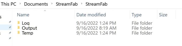

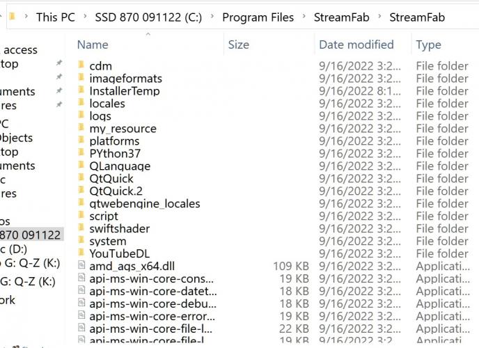

      It installed programs in (see attachments) a new StreamFab\StreamFab path instead of a sub of DVDFab\StreamFab.
      Up until this version, it was also just installing in DVDFab\StreamFab path.
      It also kept the old logs & temp folders in DVDFab\StreamFab (I manually deleted them so they were not in two places).
      It also goes to the new StreamFab\StreamFab folder when I choose "Open Logs" from within StreamFab program.
      Was surprised to see the new path installs.

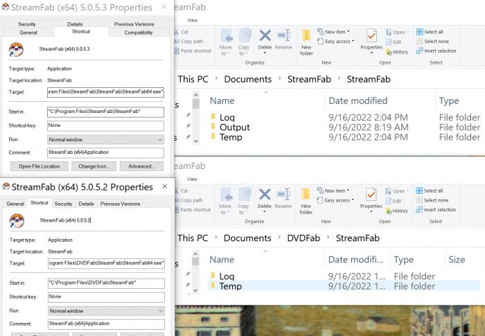

        Cats4U,
        Just to see if it repeated.
        1. I uninstalled the new version, 5.0.5.3, using Windows uninstall programs and checked removed configuration, then
        2. Re-installed 5.0.5.2 from offline installer.
        This time I didn't manually delete the Logs & Temps from old path and included a screenshot (see attached) with how the icons for each version show/created in the different paths.
        Also showed how old log & temp folders are in 2 paths after removing 5.0.5.2 & installing 5.0.5.3.
        1. 5.0.5.2 created everything under \DvdFab\StreamFab again &
        2. 5.0.5.3 created everything under new path \StreamFab\StreamFab again.
        Like I said, it was odd that this happened and I didn't do anything different during uninstall & reinstall than I've been doing.
        Mike

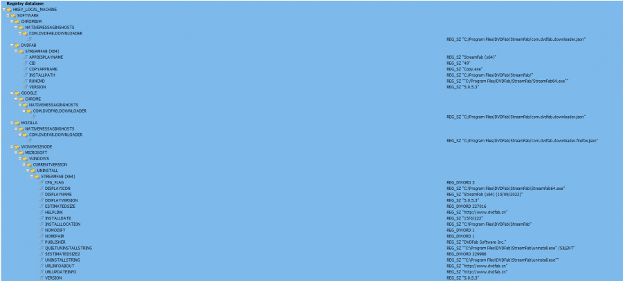

                The Registry is interesting. One thing I noticed with the Ashampoo Installer, it always shows that StreamFab uses exactly 28 registry entries. That has never changed since my first version. If you are seeing more or less of them, you might want to look into it. Here are two screenshots of the Registry entries I have. I hope they are readable. Sorry about the two background colors. I highlighted in blue when I didn't have to for a screenshot. There probably is a better way of doing this but I don't feel like exploring at this time.

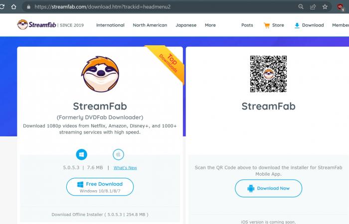

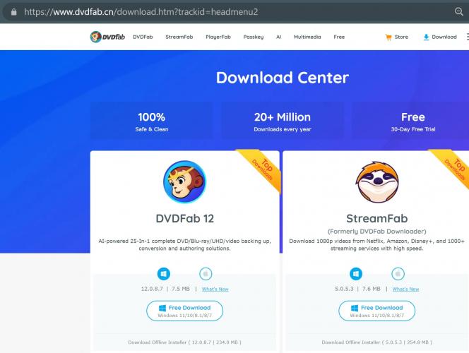

                      Here's what may be happening with StreamFab release installing in different paths of \DvdFab\StreamFab or \StreamFab\StreamFab according to a message received from Mona.
                      Message received:
                      "If you first installed StreamFab from streamfab.com and then run the one from dvdfab.cn website, you might have the problem. In this case, please remove them, and then only install the software from one site.
                      The developer still needs to discuss how to handle this situation.
                      Thanks.
                      Mona
                      I know in the past I've installed using the link to the new StreamFab offline version that installs to \DvdFab\StreamFab.
                      When I went to do this last time I remember getting an error trying to access the link from this forum so I typed StreamFab.com in my browser and downloaded the offline version from there (see attached #1) instead of from Dvdfab.cn (see attached #2).
                      It appears that doing the opposite order of installations (DvdFab.cn/StreamFab.com) from the order in Mona's message (Streamfab.com/DvdFab.cn) also may cause this.
                      This is new to me and the developer definitely needs to look at this.
