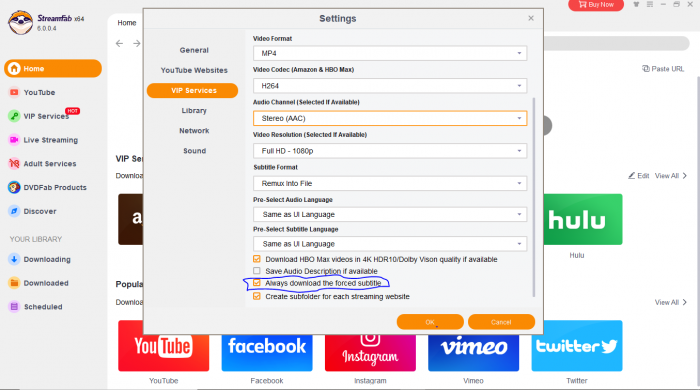

            Yes, that is exactly the issue. As I have already said, the StreamFab settings are on to always download forced subtitles, and they are NOT showing up when I play the file in PlayerFab, so my problem would seem to be either a bug in the software or some setting in either StreamFab or PlayerFab that I do not know about. It would seem highly doubtful that PlayerFab cannot properly display the Forced Subtitles if they are actually in the download from StreamFab.

              Sounds to me like you didn't select the forced subtitles. Download them and see what happens...Subs settings in StreamFab are a total shit show. That checkbox doesn't work on Amazon my experience... I think it works for Netflix but i am not 100% sure
              After that, in VLC, go to Subtitle | Sub Track and pick the Forced subs

                Amazon does not have any subtitles burned into the video for this series. They are stored separate from the video, and your player can enable them or disable them.
                For Rings of Power S01E01 there are 2 options of English sub title tracks that you can download with StreamFab (and a competing product that I also tried).. English [CC] and English Forced Narrative. You may have to scroll through the list to find both.
                If you download the English [CC] and have it toggled on during playback, it has the full movie dialog subtitles, including the non-English translations like at 24:26 "[in Quenya]
                Lindon receives you with grace.​" and 24:29 "With grace I am received".
                The English Forced Narrative has just 3 lines of subtitles. at 15:17 "Snow Troll", at 24:26 "Lindon receives you with grace", and 24:29 "With grace I am received" and that is all. These are 3 Non-English language speaking parts. These are considered the "forced subs"
                When I download either of those Subtitle tracks, and toggle them on, they show on the video, not in the black space below when using VLC or PlayerFab.
                This has nothing to do with StreamFab downloading as 1920x1080 or 1920x800 as you question in your original post.
                Keep in mind that downloading and playing back using VLC, PlayerFab, Kodi, Plex, or the like, can be different than how Amazon's native play works (either via web or streaming device). For example, by default VLC renders subtitles over the video, but if you go Tools -> Preferences -> Subtitles/OSD you can adjust Force Subtitle Position (default is 0px) to have it show lower on the screen. PlayerFab has a setting for top or bottom of the video.
                Now, why doesn't StreamFab download the English Forced Narrative if you have "always download the forced subtitles" checked? Unfortunately subtitle tracks are not always labeled consistently. This makes it difficult to detect when downloading. In this case it could be that StreamFab doesn't recognize the description for these subs as being the forced, as it does appear that it could be the descriptive subs as well. This is something we should post logs for, and ask the developers to check. Maybe they can update the app to catch forced subs named this way?

ID:	418197do you have what is circled in the picture selected ??
                    Thank you jpp72, that is an amazingly simple and obvious answer! And it certainly looks like the right one - I had NOT included the "forced narrative" subtitles, mainly because I did not understand what they were. I was relying on the Settings check box that said it would "Always download the forced subtitle". I guess you cannot always believe what you read (or maybe that really is a bug)? Anyway, I am re-testing this now with the "English forced narrative" checked.
                    CONFIRMED: When I included the "forced narrative" subtitles, the translations now show as expected. Thank you all for your help getting me sorted out in this matter - too bad that it wasn't more obvious so that I could get all the needed information included in the first downloads. Now my worry is knowing when I need to look for an additional "forced narrative" subtitle instead of just relying on the check box in the settings.

                      You're very welcome
                      As i said, i am pretty sure that checkbox works for Netflix. Other services, just make sure to double-check.
                      I don't have that problem as i always download full subs in English, French and Romanian. My wife loves English subtitles and she has made me a convert, We have them on all the time. French subs are for my parents and Romanian ones are for my wife's sister. I bought StreamFab 60% because i wanted to download shit with these 3 subtitles. When i download from the scene, having 47 subs i don't need just annoyed the shit out of me. Yes i could remove them but the other 40% was to be able to download stuff in H265 instead of converting shit and losing quality like i was doing before
