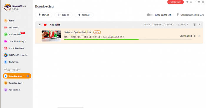

      no issues here - Click image for larger version

        Interesting. And I tried several times. Since you have to enter your cable provider, I wonder if that has anything to do with it? I'm with Comcast (Xfinity).
          i never had to enter a cable provider, just went to here - https://www.foodnetwork.com/ clicked shows then choose the episode to download.
            Ahhh, so basically you cheated.
            You went to the main website of Food Network which you can get to via the Youtube module whereas watch.foodnetwork.com will only work with the DRM MPD module and you have to name your cable provider. I'm pretty sure the "watch" site has a lot more videos.

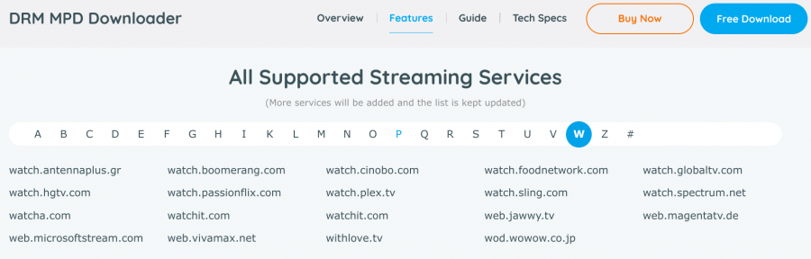

Name:	Screenshot 2022-12-25 12.44.36 PM.png
            The weird thing being that although it uses the DRM MPD module, it doesn't use DRM. It is just straight DASH. To make matters weirder, all those videos I tried to get last night but couldn't, I was able to get today with no problem. I still got the error but I ignored it and was able to download. I tried ignoring it last night, too, but it wouldn't download. If you are the kind of person that likes challenges to your brain, StreamFab is the program for you. My Mom used to keep her mind active with crossword puzzles. I have StreamFab.
