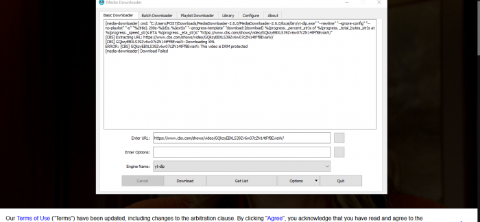

          CBS does too use DRM - Click image for larger version

            That's impressive...a picture no one can possibly read.
            I had ZERO problems downloading it.

                  the only mpd that i'm finding is the one for the advertisements.
                    Access to CBS.com is governed by being a user of a cable TV provider so ytp-dlp needs the appropriate options added. Tubedigger also needs cable TV info added. In the case of yt-dlp it would be these options -

                    With October262's (barely readable) example, it does not show any MSO options listed. I don't know if he has a TV provider or not but without the options listed he will get the "DRM protected" as he did. StreamFab has no way to manually add the MSO options to it's internal yt-dlp coding. You have to go through the motions of clicking the "TV Provider" button and proceeding through the Adobe authorization. This authorization doesn't always seem to work properly. I'm not sure who is to blame for this. For a time here there was a long discussion about trying to access Telemudo through NBC.com and/or Peacock. The Adobe authorization never seemed to work right there. I think there was also an Adobe problem with TCM (Turner Classic Movies) at one point. I'm not sure if any of these Abobe problems were fixed and by whom.

                      i don't have a cable/sattelte provider so that's the reason for it not working.
                      earlier, i tried with streamfab and it did download without any kind od sign-in.
                        The MPD is there...but you'll need to search for it. CATS4U is correct, you need a cable or other subscription to download. There are a few episodes for each show that are not locked, so if you are looking to download a series...you'd have to keep up weekly or miss the free episodes. As I stated...Widevine is not enabled, but it is set up to use both Widevine and Playready when they decide too.
