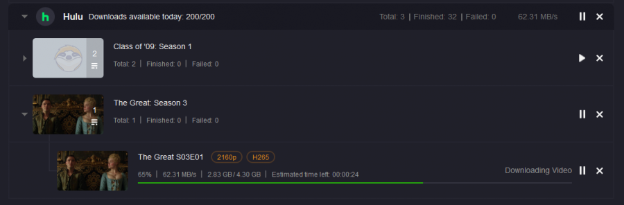

                  I am finding that streamfab, for me, has been HORRIBLY SLOW with HULU on all of it including the download speed and processing time. Here's a screenshot of streamfab downloading a 4k video, and the main competitor flying down a 4k video. Both are coming in on a 2G fiber line. Speed is not an issue with anything but streamfab. I have been having this problem with Streamfab and nobody else since upgrading to 6.1.2.1. The screenshot is of the current 6.1.2.2. This happens on ALL of my computers.
                  Streamfab... what is going on???

                    I have also noticed that the processing is much slower but the download speed remains unaffected for me.
                    This is my speed 5 minutes ago with 6.1.2.1 on a 1.5Gbps Fiber connected to a US Server from NordVPN (I am in Canada)

                      If you are going to use 2160p/H265 of course the processing is going to be slower. H265 alone is a CPU hog and then you double up the resolution. That's a lot of bits to process. For test purposes set your download to 720p/H264 and see how fast it processes.
                      As far as the actual downloads on HULU, I am achieving greater than the 800 mbps that Comcast claims I'm set up for. I'm maxing out at 117 MBps on HULU. No other streamer on SF does that.

                        This was just an example screenshot. I don't download TV Shows in 4K. Only movies. Obviously the bigger the file, the longer it takes to process.
                        My observations are that at 1080p/H265, the processing is way longer than it was when 1080p/H265 was implemented.
                        I just did a test right now with a single episode of 9-1-1 Lone Star with v6.1.2.1 x64 and v6.1.1.0 x86. It's even possible the 32-bit version is slower than the 64-bit but i didn't want to uninstall 6.1.2.1. Different architectures can co-exist so it's great for comparison testing on the same hardware.
                        v6.1.2.1 Processing and Remuxing: 1 minute, 35 seconds.
                        v6.1.1.0 Processing and Remuxing: 1 minute, 1 second.
                        The resulting files are bit-for-bit identical.
                        This means v6.1.2.1 is a full 50% slower than v6.1.1.0.
                        I also noticed that 6.1.1.0 processes the video and audio separately but 6.1.2.1 does them simultaneously. I don't know if it's because they changed it in the recent versions or if it's because the 32-bit can only use 3GB of RAM so it's better to process separately as opposed to x64 that can use my full 16GB of RAM
                          Wow, that's interesting about the version difference. The only thing that I've seen change is that SF started using an early version of FFmpeg.exe 6.0 with v6.1.2.0 for all but the Youtube/M3U8 videos (and maybe the MPD, as well). I've been using the newer nightly versions of FFMpeg 6.0 in my modified V6.1.2.1. Either way I'm probably not seeing the delay because I have my settings default to 1080p/H264. I have so many terabytes sitting around unused that it doesn't make sense for me to overwork my CPU with H265.
