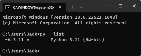

                Luckily, because the StreamFab python is not in the PATH, it is not accesible by malicious actors unless they target the exact location of StreamFab's python.
                Running py --list on a machine with Python and StreamFab only shows the version that can be run is the non-StreamFab one
